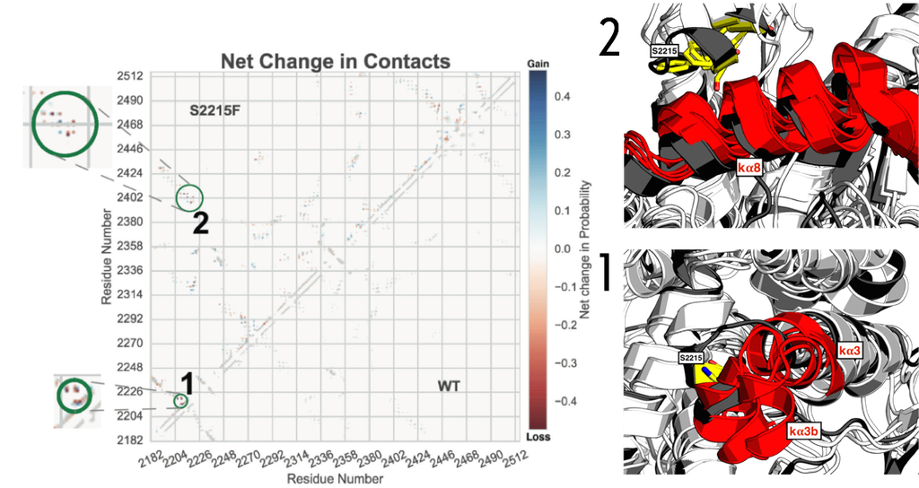

In a paper recently published in the Journal of Clinical Investigation, researchers in the Hsieh and Chodera Labs at MSKCC characterized these clinically observed mutants. Combining experiment and computation, the paper details how these mutants cluster into distinct groups that can cooperate with each other to increase the kinase activity levels above that of a single mutant, suggesting multiple mechanisms for activating mTOR. In Folding@Home Project 10495, these mutants were simulated and analyzed to identify structural rearrangements that might play a mechanistic role in activating the protein. Thanks to the donors at Folding@home we’ve now completed over 225,000 work units, or the equivalent of 2.25 milliseconds of aggregate simulation time. In mutant S2215F, a number of contacts were predicted to be disrupted, suggestive of regulatory alpha helices moving away from each other. The results of this work suggest a framework to identify patients carrying mTOR mutations that make them candidates for treatment with mTOR inhibitors, potentially benefiting millions of patients who before would not have been candidates for this type of therapy.
In the figure below, you can see some how Folding@home data can start to tell us about the microscopic mechanism underlying how mutations observed in patients could activate the kinase and cause downstream oncogenic changes.
We've only begun to scratch the surface of the enormously valuable mTOR dataset, so stay tuned for many more insights to follow!
(Top) Contact map showing the difference in probability of forming a contact between WT and mutant S2215F. (Left, upper) Region two highlighted in contact map, showing a structural perturbation in helix k⍺8. Starting structure is shown in gray, the residues indicated in the contact map are shown in red and residue 2215 is shown in yellow. (Left, lower) Region one highlighted in contact map, showing a displacement and relaxing of helix k⍺3. Color is same as above. All trajectories started from PDB: 4JSV from Yang et. al, 2013
