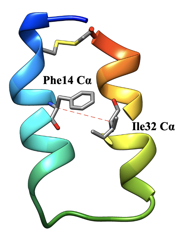

We use the MEMM approach to model the folding reaction of a small two-helix protein called Z34C. At room temperature, this protein has a folding time of about 10 µs, and an unfolding time of nearly 1 ms. When we performed unbiased simulations, few trajectories starting from unfolded states actually fold, and no trajectories starting from the folded state unfold. After adding biased simulations to our dataset (harmonic restraints on the distance between the alpha-carbons of Phe14 and Ile32), we find that we can sample folding and unfolding events, and obtain MEMMs that predict folding rates and populations in good agreement with experiments.
